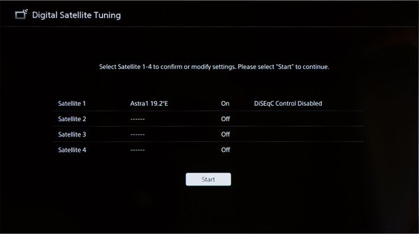

  5. Screen13.jpgIn this step you will see the list of available satellites. How many and which satellites you see depends very much on your antenna configuration. If you have a basic set-up with only one dish and LNB your screen will probably look like this screenshot. You can start the tuning process now. If you’re an advanced user, read on for how to customize your scan.

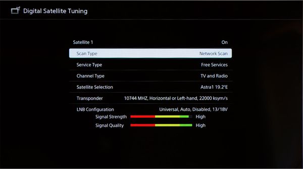

  6. Now it’s time to configure the satellite tuning process. Select the satellite you would like to configure by using the up and down buttons on your remote. Confirm by pressing ‘Enter’.
         a. Screen15.jpgThe first option allows you to enable or
             disable a satellite – usually you
             keep it activated.
         b. The next option allows you to change
             the scan type:
              > ‘Full Scan’ performs a full scan of all
                 channels within this satellite.
              > ‘Network Scan’ performs a scan
                 within the transponders of a
                 network (NIT scan).
                 This scan type is much faster than a full scan but you have to enter a transponder from
                 which the TV can get its network information.
              > ‘Manual Scan’ allows you to search for transponders manually.
                 Please note that you can’t tune for single stations – usually you receive
                 4-8 stations per transponder.
         c. Next, choose to tune for paid and free channels or free channels only. If you don’t use a CI+
             module to encrypt paid channels, select ’Free Services’. The TV will not scan for all the paid channels.
         d. As digital satellites provide lots of different services like TV, radio and data services the next option lets
             you select the channel type the TV should scan for. Select the appropriate option.
         e. If you have selected ‘Network Scan’ or ‘Manual Scan’ you can select which satellite you search for
             stations. Select the correct satellite from the list. This option is not available when selecting ‘Full Scan’.
         f. The transponder details need to be added when performing a network scan.
         g. The last option is the LNB setting screen. If you have an unusual LNB type you might need to change the
             settings according to your LNB but often no changes will be needed. The settings for your LNB can
             be found in the LNB manual, which your landlord or the satellite dish technician can provide.
