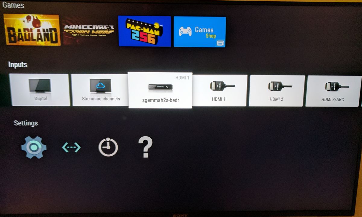

I have a Zgemma H2S satellite box connected to my KD-43XD8305 via HDMI1.
I have the TV button on the sony remote set to the satellite box.
HDMI CEC is enabled on the Zgemma box, and with the Sony remote i can control "almost" everything on the Zgemma, but not everything.

However.... the number buttons do not control the Zgemma box.
When I press any number button, it controls the inbuilt digital TV inputs and not the Zgemma box.
any ideas what I need to do to get the number buttons to control the Zgemma box?

actually i just worked it out.
settings > external inputs > bravia sync settings > device control keys.
it was set to "normal", i changed it to "tuning keys", and it now works.

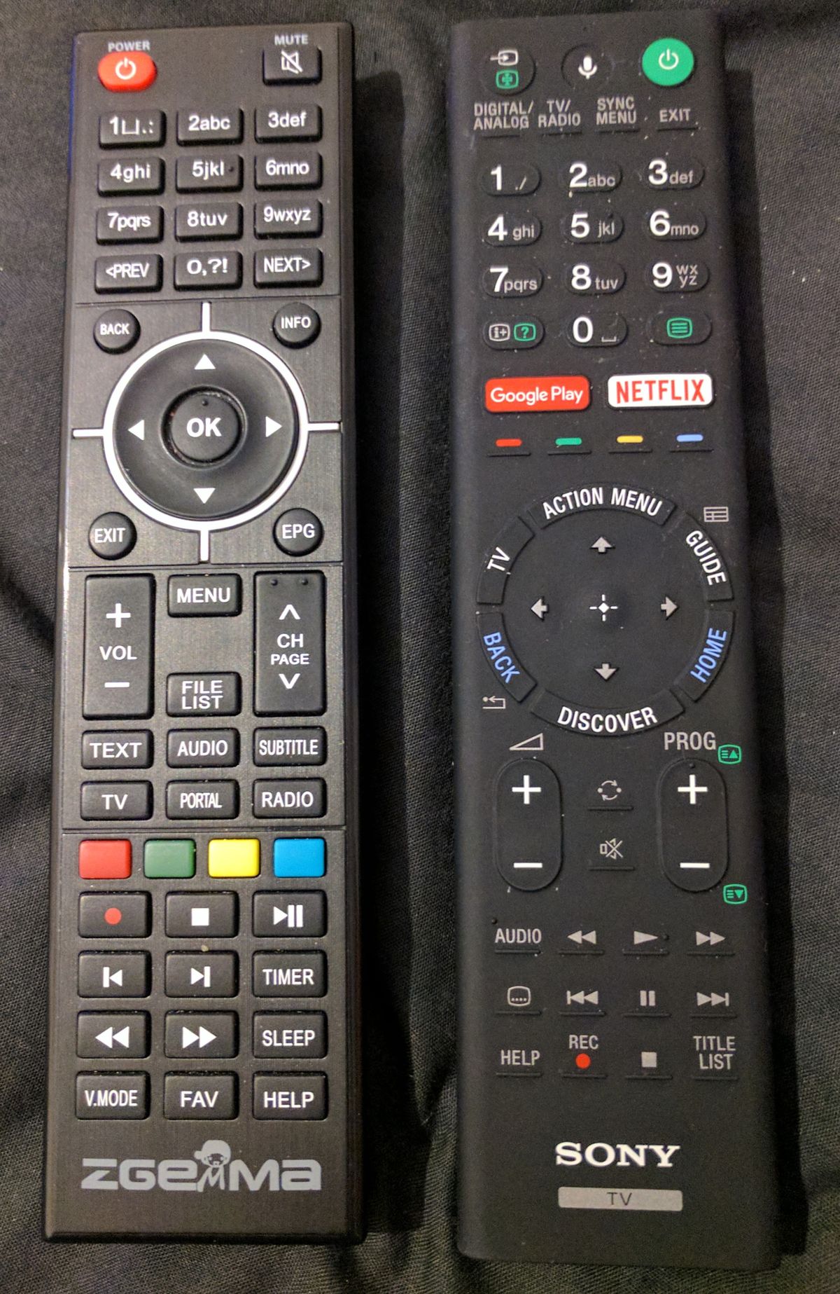

the only issue i need to solve now is that the remote for the Zgemma box has a PREV and NEXT button, but the Sony remote doesn't.
so i need to work out how to replicate the functions of those two buttons on the sony remote!
Unfortunately I dont have a clue on that one im afraid - sorry.
