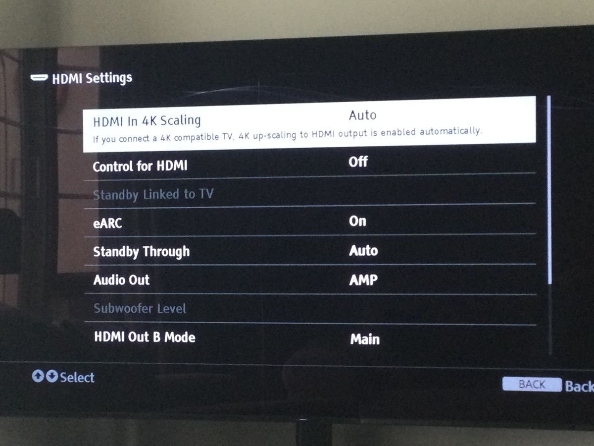

Ive got HDMI from sky box to tv for pictures, and hdmi from tv to receiver for sound. Works perfectly (tv set to av receiver for sound) until i try to use the tv remote for the receiver by turning “control for HDMI” to on. Please see pic as to set up at present

Hi Lisapc1701, I noticed that the control for HDMI on the receiver is off, did you try turning it on? Also, did you try unplugging the TV from the mains and disconnecting all the leads?

Hi, I had to turn the control for hdmi to off else the tv would turn off the surround speakers and only use the tv speaker
