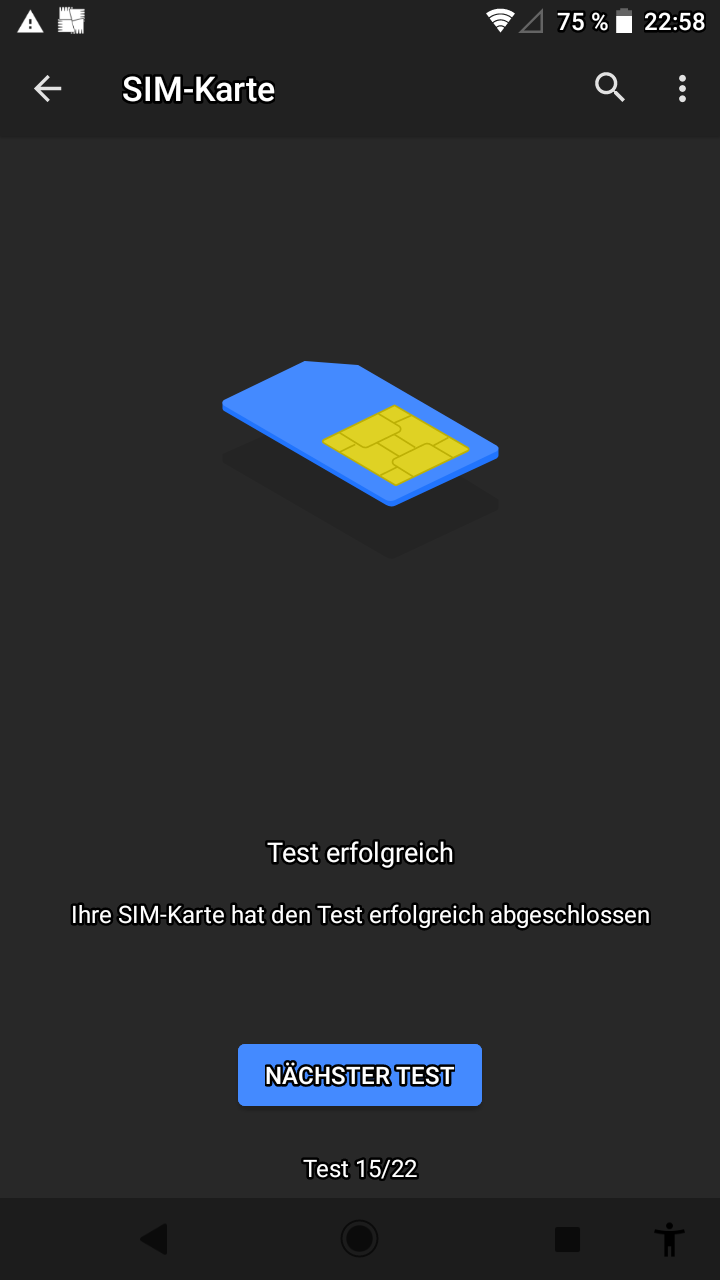

Und mein Sim slot ist nicht defekt. - - >

Strampke
For testing you don't need *#numbers
Everything is present in the Support app including the User Guide of your device.
