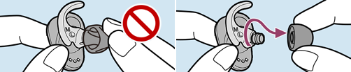

Removing and attaching the earbuds in the correct way
The correct way to remove earbuds from the earpiece is by holding the unit, twist and pull to remove the earbuds.
Don't pinch and yank it off. Gently squeeze and rotate.
After cleaning and maintenance, firmly reattach the earbuds completely, making sure the earbuds are not loose or skewed. The earbud should completely cover the sound tube.
