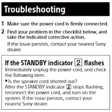

Problem: On power-up the STANDBY indicator turns on, INITIALIZE flashes on the display and then STANDBY indicator blinks. The unit will not come out of standby mode.
User manual says that this can be caused by incorrect voltage or a low impedance on the speakers.
  • Mains plug and voltage are correct (240 V AC).
  • Speaker resistance measurements are 5.2Ω and 5.7Ω which is as expected for a 6Ω nominal loudspeaker.
I have powered down for 30 minutes and tried again with speakers disconnected. Same result.
Are there any button combinations to force it to give a more detailed error code or start up?
Thanks.

Sony Support Team gave me a slightly garbled / unclear version of the reset procedure by email. I figured out the following procedure.
Problem:
CMT-SBT100B on power-up displays INITIALIZE and after a couple of seconds STANDBY indicator blinks continuously. Unit cannot be switched on.
Solution:
Reset the unit.
  1. Unplug power, wait for STANDBY led to turn off - then wait another five minutes.
  2. Plug in the power.
  3. As soon as the STANDBY indicator turns on hold the CMT-SBT100B stop [square] button and simultaneously press the remote (RM-AMU171) VOL+ button. You have to be ready to do this before the STANDBY indicator starts to blink.) Hold for several seconds. (10s should be more than enough.)
If all is well you might see INITIALIZE blink three times and the STANDBY light will remain on. Pressing the I/O button will switch the unit out of standby and main display will light up.

I have struggled to reset using my procedure above on several occasions. The problem seems to be that the amplifier thinks there is a loudspeaker circuit fault. If the procedure doesn't work then disconnect / unplug the speakers before trying the reset. This works reliably for me.
