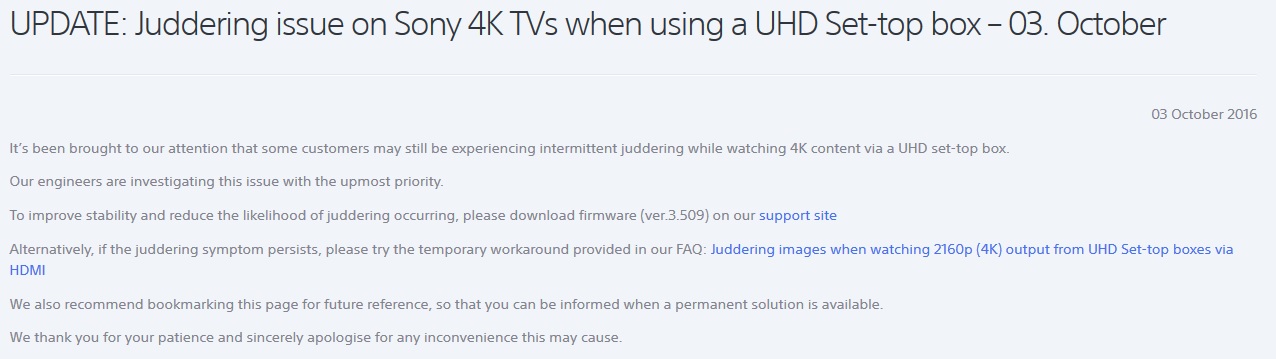

Hi all
Sony have updated their statement:
